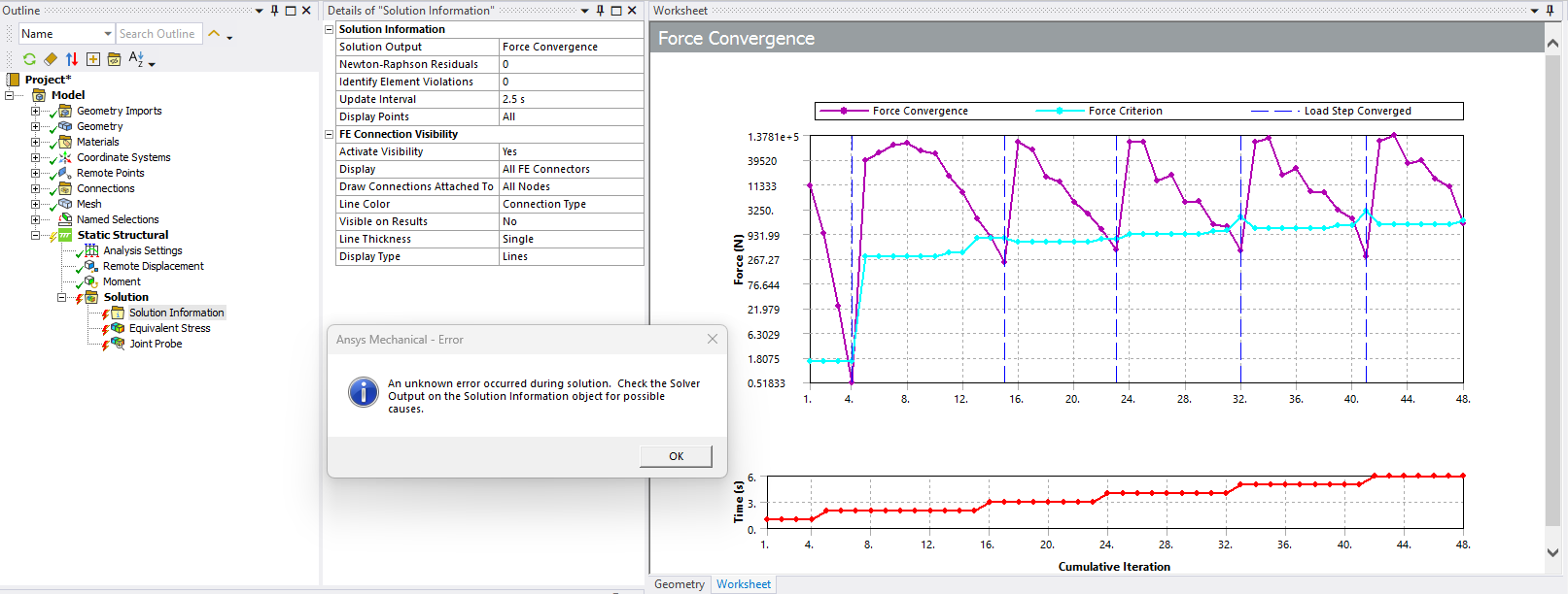

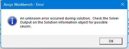

If I import the .mechdb into GUI, it shows the red flash, and an error message
But When I checked the .out it just looks fine, without any error.
I'm not sure what has happened.
