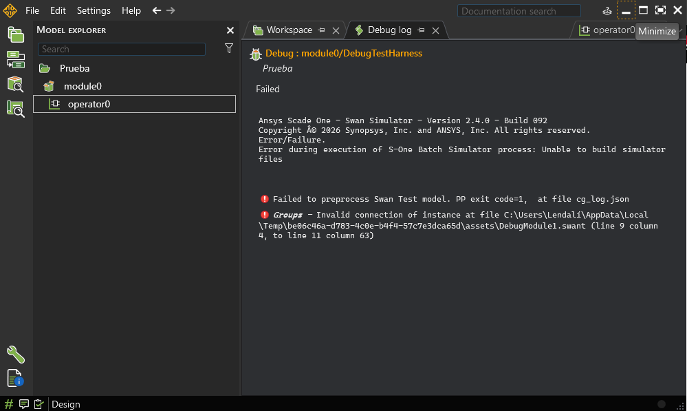

Hello, I am having an issue with Ansys Scade One. When running the simulation, the following error appears:
Unable to build simulator files
Failed to preprocess Swan Test model
Groups – Invalid connection of instance
No errors are shown in the modules, blocks, or connections in the editor.
I would like to note that I have previously completed other projects using the same version, and they worked correctly.
After several tests, I noticed that the error only occurs when using arithmetic operators, such as:
addition, subtraction, multiplication, division, modulo, negation, and type casting.
If I remove these operators, the simulator runs correctly.
Could you please help me with this issue?
