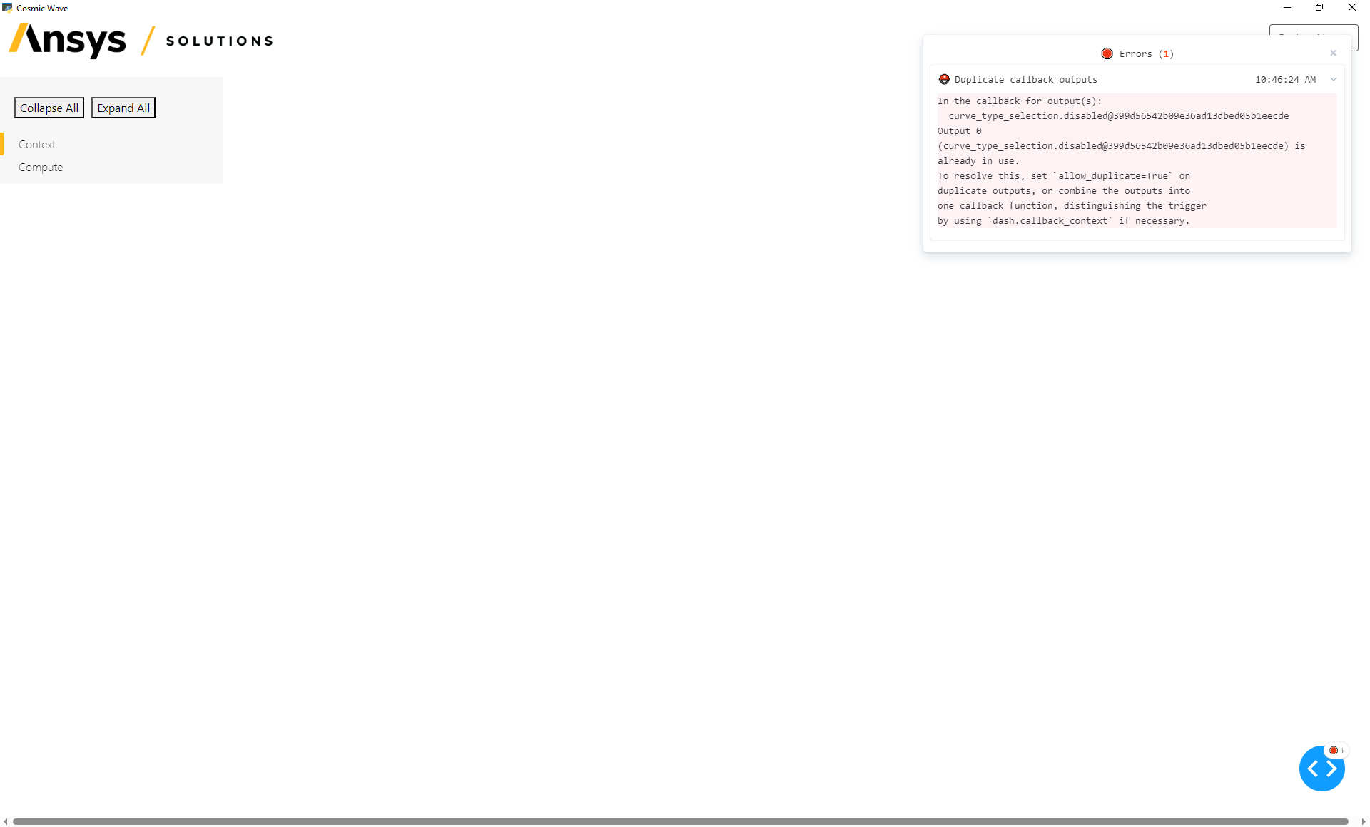

I have recently been confronted to the following issue with Dash:
I have two callbacks which point to the same output curve_type_selection. Here is the code:

I added the allow_duplicate option to get ride of the duplicate outputs error as recommended in Dash documentation. But still I am getting the error message.
Solution
The solution can be found here. The issue was actually not with the outputs, but rather with the inputs. The workaround is to either switch the orders of the inputs wherever possible, or add a dummy input wherever necessary.
