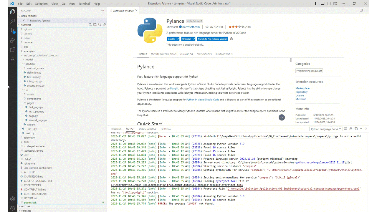

Currently, if I rename a Python module with Pylance version 2023.11.10, the references and imports with this module are not identified or changed. Similar issue has been reported here.
Proposed workaround
I fixed this issue by downgrading the version of Pylance to 2023.10.10. To install an older version of a VSCode extension, I followed the steps documented here.
