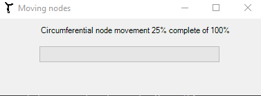

I've a question about updating a progress bar, which I created with Windows Forms.
When I go through a nested loop, I try to update every 25% the progress bar, which works for the label I created in the progress bar ui, but the progessbar itself is behind. For example when I reach 25%, the label shows 25%, but the progress bar is at 0. When the label is updated to 50%, which works, the progress bar shows 25%. Is there a solution for this?

    Not sure why. A work around you can make two text boxes as read only with different colors and change the length of the “progress” box from 0 to total width.
    Maybe that would expose what is going on with the progress bar?

    Thank you for the help. I have now chosen the variant with the stacked text boxes, which looks a bit cleaner and runs better. However, this variant is still not entirely clean, as the GUI continues to freeze and does not run smoothly even in a separate thread.
