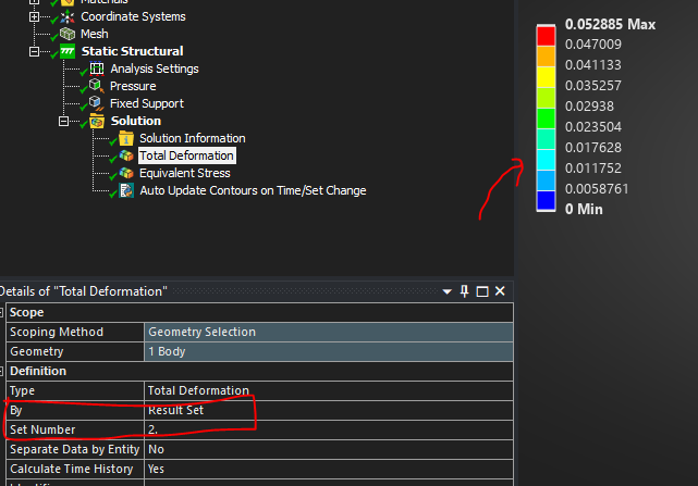

Example of how to use a python code object with the On Object Changed callback to trigger the auto-evaluation of results of other contours.
When you change the value of the time or results set in a specified object, the contours will auto update instead of needing to RMB>Evaluate Results.
Mechanical Standalone project (.mechdb) attached as .zip.
