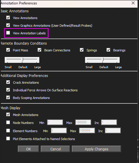

Hi
Mechanical Scripting
does any one know how we can switch off the annotation labels from the Display -> Annotation -> Preferences
using scripting?
Thanks
Kanchan

Here you go:
Graphics.ViewOptions.AnnotationPreferences.ShowLabels = False
See this section in the help for v2024R2
