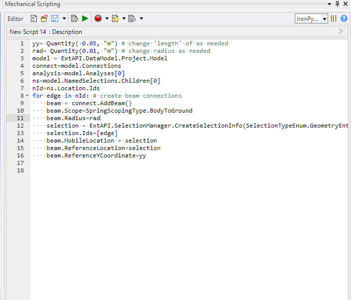

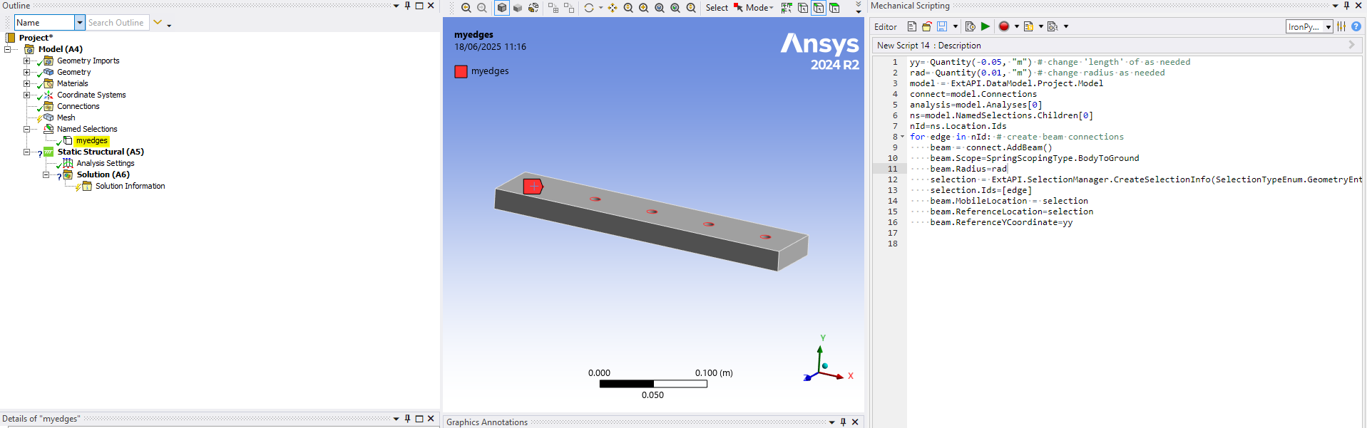

Say we have a named selection (myedges called below) that contains edges where we want to define body to ground beam connections to. Is there a way to automate this using mechanical scripting?
Best Answer
  • Erik Kostson
    Erik Kostson Member, Moderator, Employee Posts: 337
    50 Answers 100 Comments Second Anniversary 25 Likes
    edited June 18 Answer ✓
    Below is a script that does that (myedges contains all edges of interest).
    Modify as needed (depth, and radius of beam connection).
