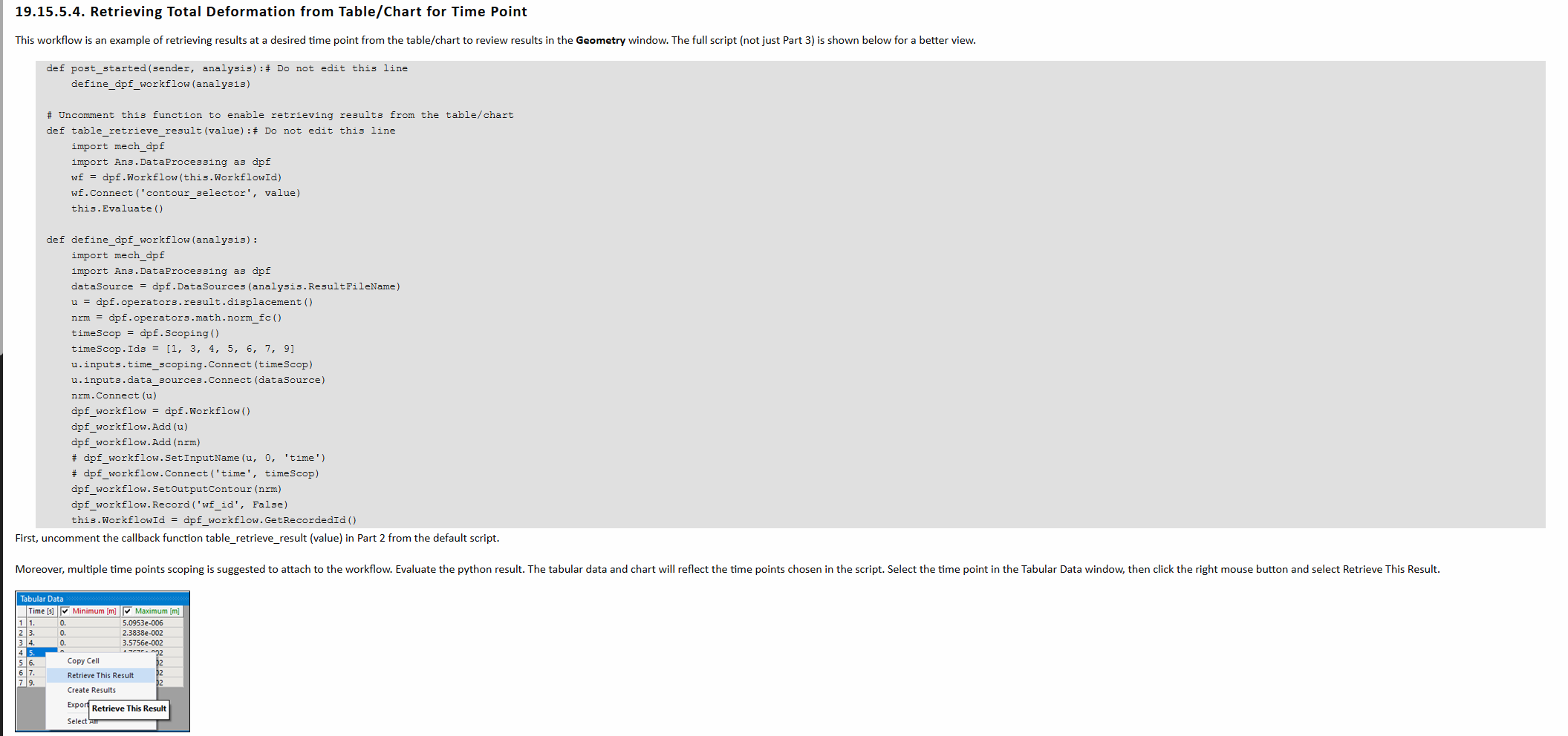

Hello,
In ANSYS help there is a following example:
https://ansyshelp.ansys.com/account/secured?returnurl=/Views/Secured/corp/v251/en/wb_sim/ds_python_result_examples_table.html
I am trying to do the same but by passing a fields container, see snippet below:
 forward = dpf.operators.utility.forward_fields_container()
 forward.inputs.fields.Connect(Data_FC)
 dpf_workflow = dpf.Workflow()
 dpf_workflow.Add(forward)
 dpf_workflow.SetOutputContour(forward)
 dpf_workflow.Record('wf_id', False)
 this.WorkflowId = dpf_workflow.GetRecordedId()
The above doesn't work, the script seems to display result for last time step. I would like to have a table of results from the fields container and allow the user to retrieve the result, is this possible and is this feature supported?

    Anyone knows the answer to the above, excerpt from the help below:
