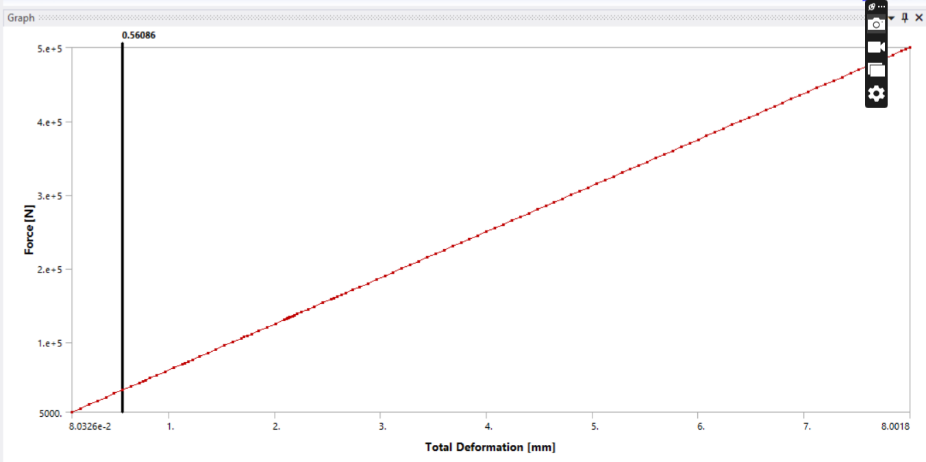

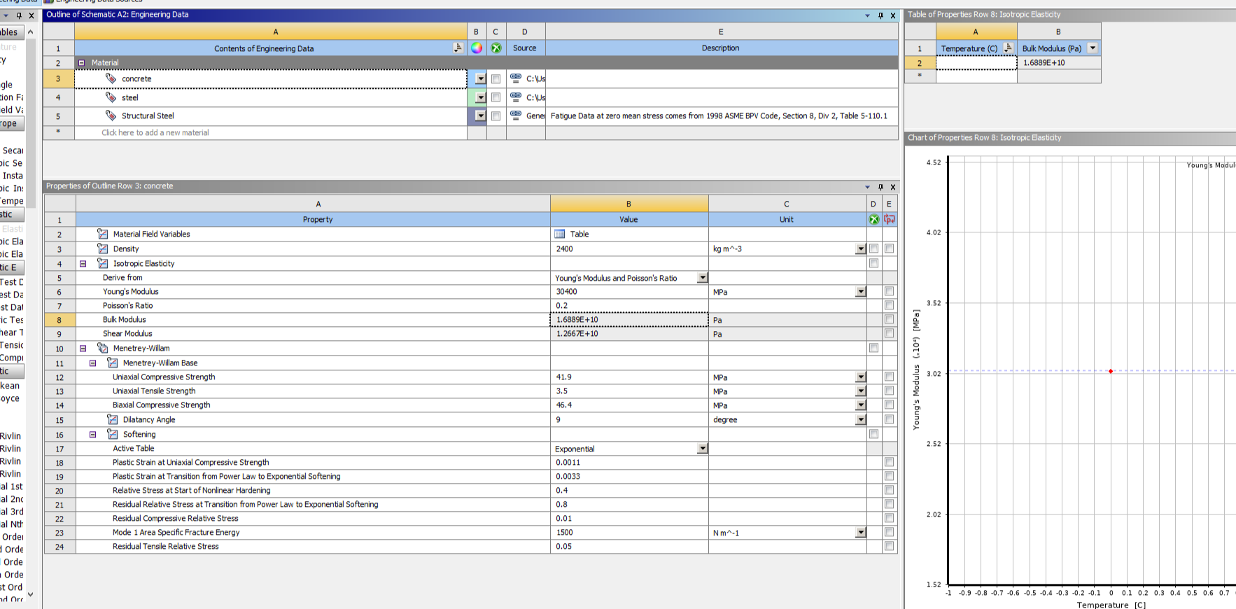

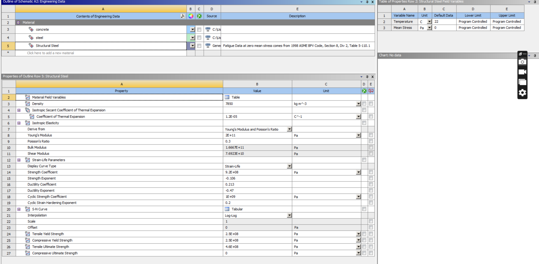

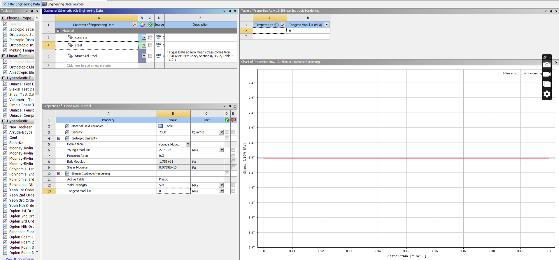

Those are the concrete and steel properties I used in my ANSYS analysis, and I obtained the force and deflection curve. Here is my equation for how I can get the maximum Force and Deflection, and where my failure Force and Deflection are?. which did the same work in experimental, and I got the maximum Force is 388kn and Deflection is 6.5mm. Can someone tell me where my mistakes are?
