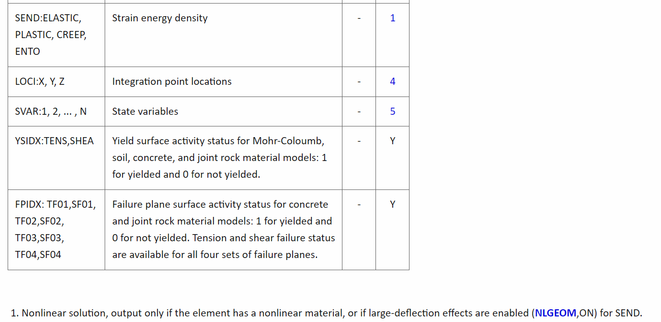

I am trying to get the strain energy from a result-file using pyAnsys dpf-core. Actually I do not see a direct access to this result (maybe there is but I just cannot find it). So I tried to acess the strain energy density so that I can calculate the strain energy using the element volumes.
However, as a result from my Python code I get an empty array, even though the results do exist - at least I can see them (print and plot) in the in the ANSYS Mechanical GUI (ANSYS Classic).
