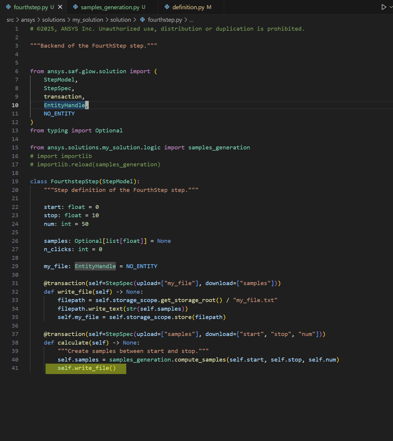

In the bootcamp, there is an example where we add two transaction methods calculate() and write_file(). This works without problems if implemented as instructed in the bootcamp documentation, that is, calling each of these transaction methods from within the page-callback. However, when I try to call one transaction method from within another transaction method, such as in the following screenshot:
then I get the following error:
The solution definition is invalid: invalid attribute 'write_file' in FourthstepStep.calculate. Please make sure that the field is declared in the step and in the transaction decorating the method. Traceback (most recent call last):
File "C:\ansysdev\initiatives\saf\training2025\my_solution\.venv\lib\site-packages\ansys\saf\glow\_executor\method_runner.py", line 179, in run_method result = self._run_method(
File "C:\ansysdev\initiatives\saf\training2025\my_solution\.venv\lib\site-packages\ansys\saf\glow\_executor\method_runner.py", line 242, in _run_method return transaction_step_method(
File "C:\ansysdev\initiatives\saf\training2025\my_solution\.venv\lib\site-packages\ansys\saf\glow\_core\transaction.py", line 327, in step_method_wrapper result = step_func(**args_for_step_func)
File "C:\ansysdev\initiatives\saf\training2025\my_solution\src\ansys\solutions\my_solution\solution\fourthstep.py", line 41, in calculate self.write_file()
File "C:\ansysdev\initiatives\saf\training2025\my_solution\.venv\lib\site-packages\ansys\saf\glow\_executor\transaction.py", line 280, in __getattr__ raise MalformedSolutionError(
ansys.saf.glow._server.exceptions.MalformedSolutionError: 500: The solution definition is invalid: invalid attribute 'write_file' in FourthstepStep.calculate. Please make sure that the field is declared in the step and in the transaction decorating the method.
Is there a reason why I cannot use a transaction method from within another transaction method? I assume this is by design?
