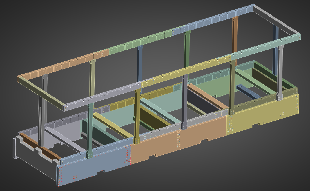

I have a model with 1,117 contract regions that were automatically created from the geometry.
I've looked through some of them and believe they are all correct. I ran a test case and the model is connected well. However some of these contacts are screws in holes, and others are flat surfaces. I'm ok with the screw contacts being "bonded", but I think the flat surfaces should be "no separation" because there is no bond - the screws should be taking the shear and tension load between these surfaces. I feel if they are bonded I won't get accurate stresses in the screws.

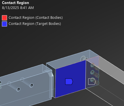

For example this should not be bonded:

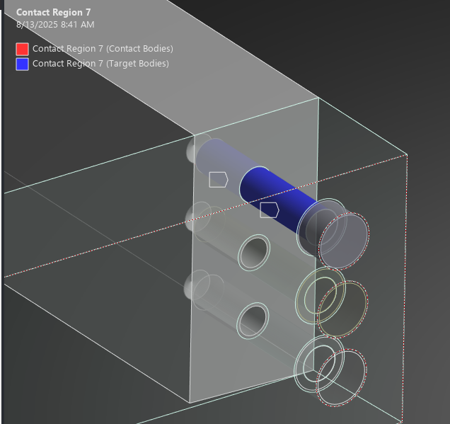

But this can be:
