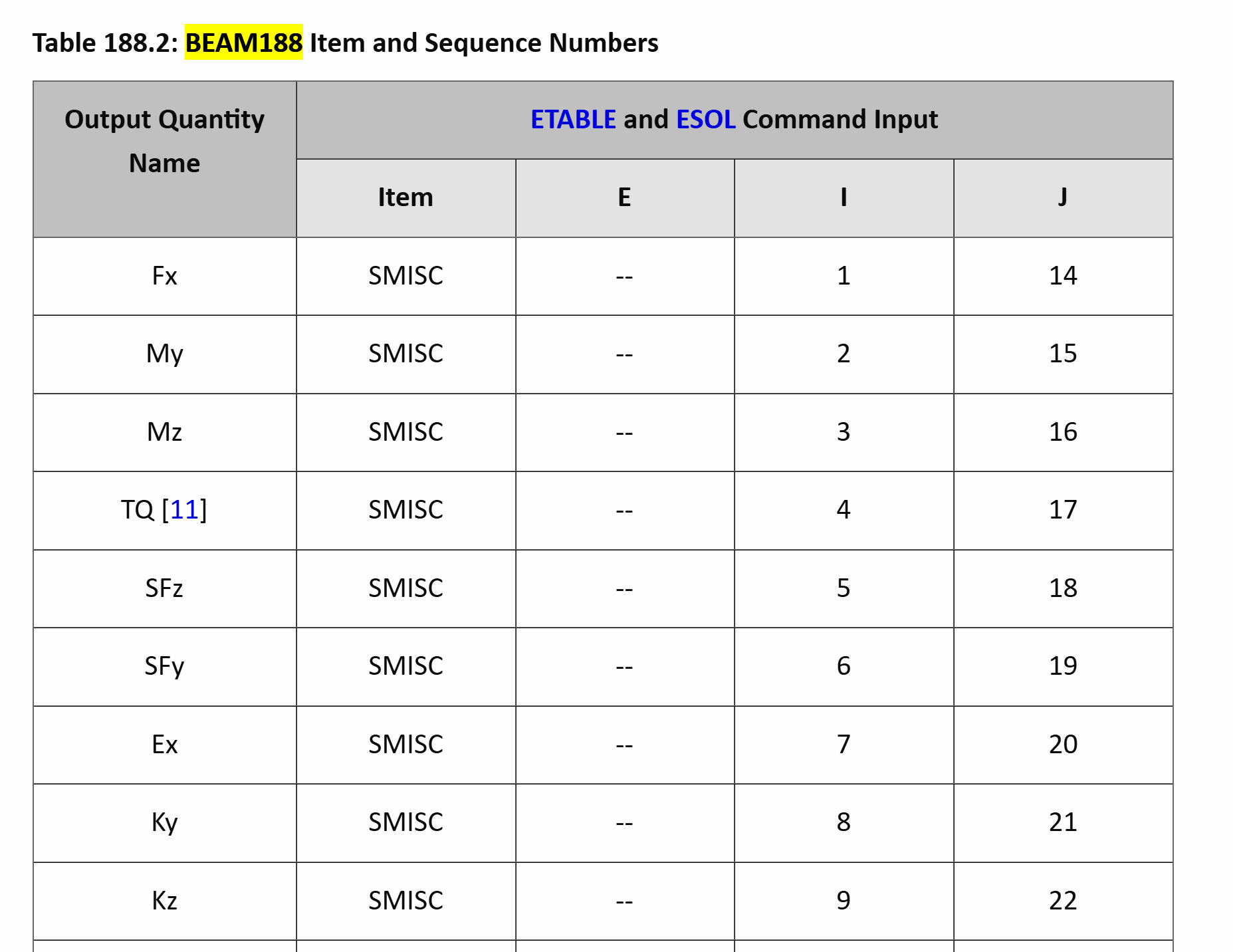

note the code above gets SMISC15, which is the moment Y at node j. There are other values for moment Z and node i, and the total moment would be the vector combination of moments Y and Z.
Torsion, shear, etc can also be found in same ways, and refer to the Beam188 documentation in MAPDL.
Refer to table 188.2 of BEAM 188 documentation, item_index input should be adapted accordingly.
