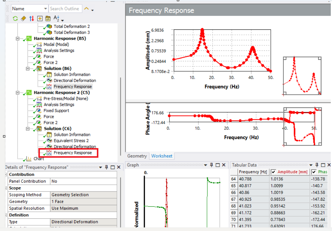

Sometimes the ability to export data is not in the API but a .TabularData allows you to access the data. But in some cases, .TabularData does not easily export.
A harmonic response is one such example.
A Harmonic Frequency Response has a .TabularData API but you need to parse it for exporting to a file.
What I did (and there are countless ways to do this) is to first set up my ACT script to get the tabular data to a parameter and use the .TabularData API to get the rows and columns of the data. (The data is a kind of dictionary).

Once I had the columns (keys) and rows, I just looped through the tabularData to write it to file. I loop through the rows first and then the columns/keys just to easily keep the same format as the tabular data in the Mechanical analysis result.
