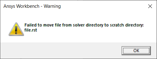

The first execution of the script runs with no problem. However if the model changes for whatever reason and the solution requires to be recalculated, the script fails.
I get this error in Mechanical
and this in Workbench:
An unexpected error occurred: Failed to back up file C:\.am\Calcoli\Tests\EsportaDatiMesh\EsportaMesh_files\dp0\SYS\MECH\file.rst: Error moving file from C:\.am\Calcoli\Tests\EsportaDatiMesh\EsportaMesh_files\dp0\SYS\MECH\file.rst to C:\.am\Calcoli\Tests\EsportaDatiMesh\.EsportaMesh_files.backup\dp0\SYS\MECH\file.rst. Il processo non può accedere al file perché è in uso da un altro processo..
