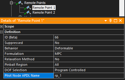

In my Mechanical Model I have two Remote Points named 'Remote Point 1' and 'Remote Point 2'. I've assigned a 'Pilot Node APDL Name' from the Details of each object, so that they can be referenced as 'rp_1' and 'rp_2' respectively:
