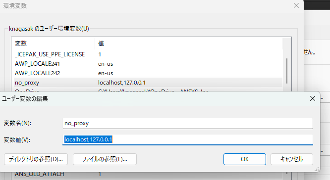

  • Shinsuke Okayasu
    Shinsuke Okayasu Member, Employee Posts: 4
    First Comment Name Dropper
    edited June 19
    @PyMotorCAD-Team , @JamesP
    I got the update from customer.
    The customer resolved pymotorcad library link error by changing environmental variable as attached picture.
    Proxy may prevent the user's PC from accessing pymotorcad.
